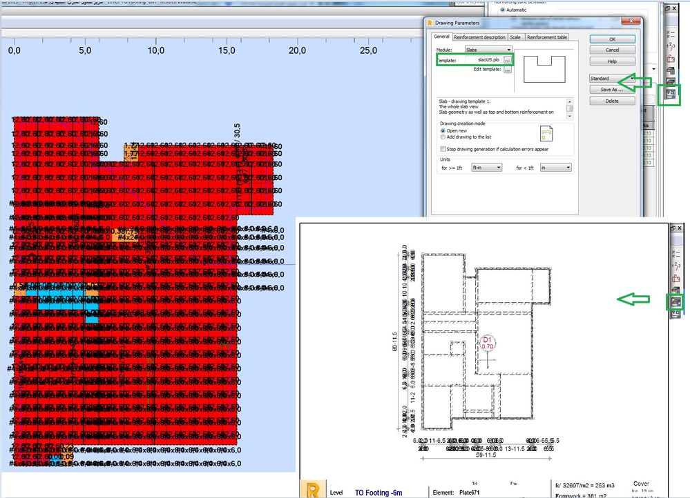

Message 5 of 9
Slab reinforcement appears but drawings don't get generated.
I'm trying to display the drawings I reviewed forums regarding this issue and nothing is working.
1- tried freezing then unfreezing the reinforcement, didn't work
2- tried changing calculation model from deck slab to shell, didn't work.
Please find attached file and pictures

Hi @Anonymous
Did you press the indicated button to generate the drawing?

Yes, I pressed the "calculate" button, then checked the "generate drawings" tickbox. An empty drawing page opens up. No errors

Hi @Anonymous
Check if you have the correct slab drawing template set before generating the drawing:
