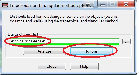

 I understand that at node 374, the  connecting beam acts as a point load on the beam between nodes 14 and 16. But this should not affect the load distribution on the beams between nodes 16 and 18 and 14 and 12.
You are right.
The nodes marked below in white are the cause of it.
Example for panel 2054
To avoid it you have to ignore bars 4999 5038 5044 5045 in cladding loads distribution
Additionally I recommend to correct accuracies in your model to avid other problems with cladding loads distribution
(grids and bar nodes also)
Sample file for your consideration

I have just had a look at what you sent over, but I think the wrong bars must have been ignored. This is because the ignored bars should have load distributed to them, have you maybe ignored the wrong bars?
Message 10 of 10
Rafal.Gaweda
Autodesk Support
Autodesk Support
This is a workaround.
If it is not suitable for you \ your model it means you have to apply loads manually for now.
