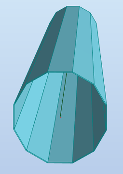

i am trying to model a tapered polygonal tower in shell. When i do extrude with scale for a circle, it works perfectly, bet when i do that with 12 n polygon, it does it like that. How can i make this right?

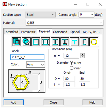

I am not sure what method you are using for such tower definition bot maybe you could consider using library (parmetrised) structure to simulate such geometry

Thank you i will try. I am trying to model a polygonal monopile tower. So this way it is modeled as 12 nodes polygon and not a circle section, yes?

Hi @simas.lembartas25CSD
Yes library tower is based on parametrized polygons.

So to be sure, if i divide it to 12 nodes, i get a model for this:

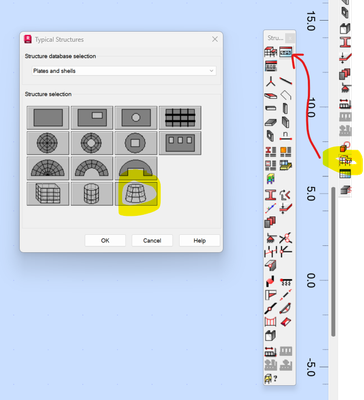

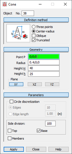

Note that, in addition to what @Krzysztof_Wasik suggested, you can also create a faceted cone by specifying the number of edges (for example, 12), along with the height and the section dimensions.
https://help.autodesk.com/view/RSAPRO/2027/ENU/?guid=GUID-66D8C755-044F-4E08-9DAF-A3DE87B57247
You may also need to account for varying plate thicknesses, overlaps, and additional components such as manholes, branch connections, base plates, and cover plates. If you are working from a drawing, another option is to model the structure using simple plates based on a reference layout or a 3D wireframe imported from AutoCAD.

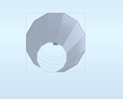

Thank you for your insight. When i try to model it from panels, it does calculations for few hours, but if i do that with cone or the method suggested by Krzysztof_Wasik, it does calculations quickly.

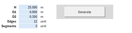

All these examples show that it is possible to access modeling functions in various ways and that modeling is easy.
Keep in mind that if your product is parametric, it is possible to automate modeling and calculations via the API. Many manufacturers are moving in this direction to automate their design processes once the procedures are established. Using shell elements instead of transformed objects provides greater flexibility for meshing and adding accessories.

Beyond modelling the shaft, the API can automate much more: connections, arm attachments, slip-joint overlaps, climatic loads (wind, seismic, ice), and code checks across several standards at once and behind a revamping project, there's often a code upgrade and ageing structure to account for too: GB, Eurocode, TIA-222, ASCE/SEI 48 + MOP 74, EN 50341. That makes it practical to compare standards or sweep many configurations in reasonable time.
On the innovation side, this can now connect to AI tools via an MCP server: an assistant can drive the model directly in natural language, generating geometry and running checks, while the engineer simply describes what to verify.
Programs can be written as a single block or, better, built in layers : more flexible, easier to maintain, and reusable across projects.
