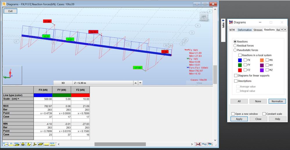

I have modelled a steel frame and I am trying to view shear forces at member ends/connections/nodes.  The viewer appears to show Fz as kN/m along each member instead.  Is there a way of viewing member reactions at nodes?

Yes, it is that simple! 🙂 It is just the shear force at the end of the member I need so I can complete a hand calculation to check the bolted connection.
When I look at the Forces table (taking member 283, at node 272 as an example from above), the max values I am getting for Fz are not what I expect for the shear force.  This should be about 300kN.  Please see image attached.
When I look at the supporting column (member 280) this has a 317kN axial force (albeit not all of this will be from member 283).
How can I view the end member reactions/shear forces?

Hi
Please see below when I try that...  21.7kN is not the end reaction I need - this should be circa 300kN.
Not sure what I'm doing wrong!

Hi @david.mackie29GRW
How do you calculate FZ force at the chord end (beam vs. truss)?

Hi
In the example you show above - I can see how you show reactions at supports.
Also, for simple beams - Fz gives the reaction at the beam end - which makes sense.
But this isn't clear for the reaction/shear force at the end of chord of a truss, which in my case is away from the supports.
I set the display in such a way that the diagrams are shown only for selected bars and nodes. If I add posts and diagonals you will see that for the truss the load is distributed to supports via axial loads in posts and diagonals rather than shear in chords.
