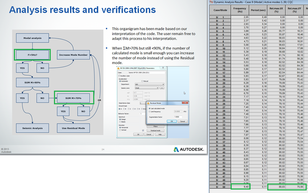

Following the modal analysis I was struggling to get 90% mass participation, even using 200 modes, is this normal?
It may happen that have many local vibrations with similar frequencies which don't contribute to increase of the mass participation factors. The solution for such situation was presented during the webinar:
Additionally my minimum frequency is less than 5Hz,
The point is that you should reach the mode which eigenfrequency is above 5 Hz

See the slide from the webinar:

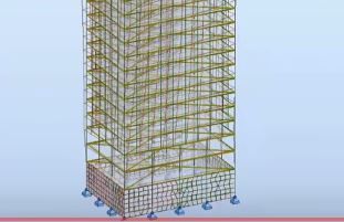

The youtube tutorial has unmeshed slabs in at each level - are these rigid links?
Correct
Does this not mean the masses are not taken into account?
They are.

R: The youtube tutorial has unmeshed slabs in at each level - are these rigid links?
A: Correct
R: Does this not mean the masses are not taken into account?
A: They are.
What is the benefit of rigid links vs rigid diaphragm?

Artur.Kosakowski
Autodesk Support
Autodesk Support
R: Following the modal analysis I was struggling to get 90% mass participation, even using 200 modes, is this normal?
A: It may happen that have many local vibrations with similar frequencies which don't contribute to increase of the mass participation factors. The solution for such situation was presented during the webinar:
Yes following the webinar I have tried to use the Residual Mode function and I still do not get 90% participation. In fact it did not change my results at all. I have also been reading your website and it seems that this function is only permitted in French codes, is this not included in EC8? What is the implication of using this Residual Mode function in terms of my results?
IMHO the principles of response spectra analysis are similar regardless of the code. Using the residual mode you will make some simplification / approximation but the whole analysis is like this. You do the same when you use diaphragm instead of meshed floor or equivalent lateral force method.

R: I have set up my slabs as shell elements, would I gain any benefit from setting them up as rigid diaphragms?
A: Smaller size of a model and less modes required especially when you have local vibrations of floors. Mind that this can be used only when you can disregard Z direction and you don't need results for floors.
When you say less modes required – does this mean it would help me to get the 90% mass participation if I set up my slabs as rigid diaphragms instead?
It should.
The rigid diaphragm is actually modeled with use of rigid links.

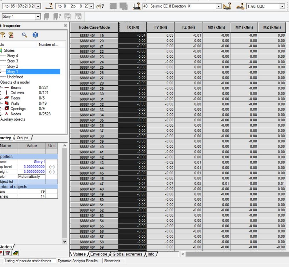

When I look at my seismic loadcases to see the forces generated automatically it is blank:

Additionally the forces generated automatically are still blank for the seismic load case as shown in the image above. Do you know why this is?
How can I find out the base shear? Seems to not be possible for EC8 but I would like to check this against my approximate calculation as model verification.
You should look at the pseudostatic forces instead.

See the attached pictures
How can I look at this? Why can I not see it in the usual manner like the example online? The summation of the pseudostatic forces in Fx or Fy does not equal the expected base shear. Neither does the sum of the reactions, how can I find this?
Thanks again!

R: When I look at my seismic loadcases to see the forces generated automatically it is blank:
A: You should look at the pseudostatic forces instead.
R: How can I look at this? Why can I not see it in the usual manner like the example online? The summation of the pseudostatic forces in Fx or Fy does not equal the expected base shear. Neither does the sum of the reactions, how can I find this?
Many Thanks,

Please could you explain in more detail how I can find the base shear using EC8?The article you reference uses a different code and therefore I do not have these options in my model. In response to my earlier post you said I should check the sum of the reactions for horizontal directions - should I be looking at the reactions for the main mode or for the CQC case or for total Fx generally?
There is one more question still outstanding:
See post 2 from http://forums.autodesk.com/t5/robot-structural-analysis-forum/cqc-seismic-forces-in-seismic-combinat...
Many Thanks,
Rosie

1. For the base shear I assume I should be taking the sum of all modes in pseudostatic forces?

3. I have found the following guidance and I am wondering at which point to apply each:
- The CQC rule for the combination of different modes should be used (EN 1998-1/4.3.3.3.2(3)).
Is that this box?
- The results of the modal analysis in both horizontal directions should be combined by the SRSS rule (EN 1998-1/4.3.3.5.1(2a)).
Where can I apply this?
Oops. It seems like I missed the attachment here. You should look at the sum of reactions for quadratic combination.
Is that this box?
These are Newmark combinations between the directions of expectations. The CQC or SRSS are between modes.
This is done automatically (program either generates SRSS or CQC combinations depending on your settings).
