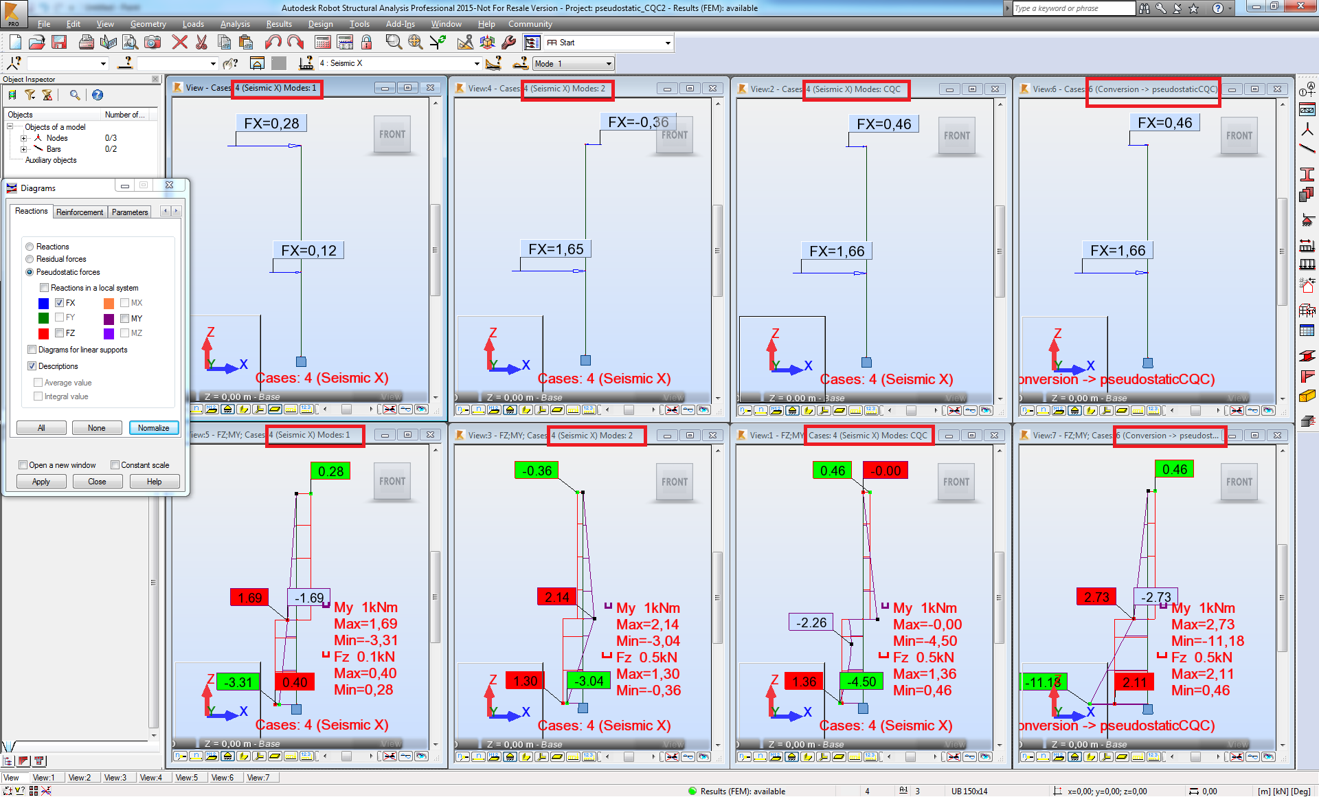

I have made a simple example with 2 concentrated masses and significant participation of both vibration modes to illustrate it on the screen capture below. It contains a seismic case with 2 modes and a static case 6 loaded by CQC combination of pseudostatic forces converted from the seismic case.
In the top row the pseudostatic forces are displayed for mode 1, 2 and CQC combination of pseudostatic forces and loads for CQC combination of pseudostatic forces converted to static case (case 6).
In the bottom row the shear forces and bending moments are displayed for mode 1, 2, CQC combination of modes and loads for CQC combination converted to static case.
When comparing results in the 3rd and 4th column very significant differences can be observed. It is so because although it is possible to display in Robot the CQC combination of pseudostatic forces this combination is not used in analysis - analysis is run only for specific modes and then CQC results are calculated from results for modes.
Additional remark related to attempts to physically interprete these CQC results - they should be interpreted as some envelope of expected values with the possibility that they can have also opposite sign (as usually in vibrations:)).
Robot gives the possibility to convert CQC combination of pseudostatic forces into static case but this feature should be used rather for selected mode. Of course such choice can be done easier if there is a single dominating mode.
