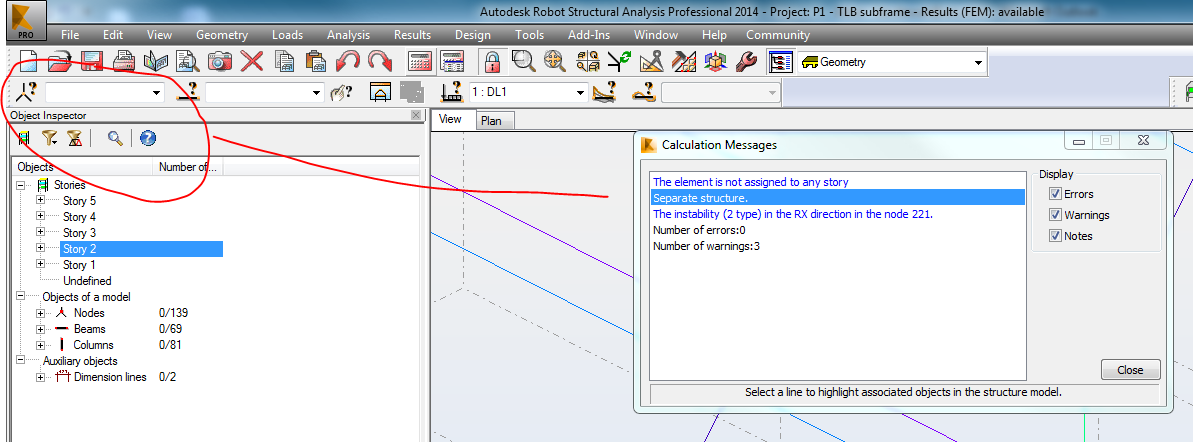

I am encountering 'Separate structure' warning for the attached model. I have ran the geometrical repairs and still occurs?
Is the warning simply due to the columns being split etc set for the intermediate storey heights?

Thanks Rafal,
My model however does not show the members where this occurs, even after I double click ?

Lee,
NODES...

Rafal,
Apologies, a bit hasty on the screen grab! Should have extended it.
Same, no nodes highlighted either. Not to worry, may just be a peculiarity for this model

Lee,
Take a look at my screen shot.
It is indicated on it to expand Nodal Selection combo and select $SUB...$ group
You can do the same on Nodal Selection window from Groups tab (select $SUB...$ group(s))
