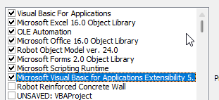

Hi
I have an issue when trying to work with RSA 2024 through the API in both VBA
and in Python.
This issue does not persist en either 2022/2023 and 2025 version?
Are there any known issues with 2024 ?
The issue is comes when trying to access anything under app.Project...

I am aware of that I cannot run calculation if nothing is open and loaded.
I run the second code snippet you have here in debug mode I see in my excel that "Project" is not available to step into. even though I have the correct reference to 2024.
Message 6 of 9
kmmdD66ZQ
This code snippet works, but even though I tick of reference in excel to be ROBOT 2024 it forces itself to open 2025.
Message 7 of 9

Message 9 of 9
Stephane.kapetanovic
I do not recommend working with multiple versions of the API in VBA.
Yes, even if you choose version 2024 in references, it is possible that your machine will point to version 2025.
A test could be to uninstall versions other than 2024 and restart the programs.
