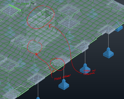

I am getting an overlapping panels warning in the attached model. The model was imported from Revit and is a two-way concrete slab with drop panels. I'm not sure if the warning is triggered by the fact that there are several interior panels for the drop panels or if perhaps there is some model inaccuracy from the import.
Appreciate an help on this.

The drop panels overlap with the slab.  It is not recommended to use overlapping panels.
How the program should know which thickness assign to finite elements in overlapping zone if they are different?
It worked as you would expect, I guess, and assigned  in most places the bigger thickness.
I can spot mismatched thickness in panels 164 and 166.
I would recommend to define openings in Revit panels where they overlap with drop panels.
You can do it using Opening By Face and Pick Lines of the drop panel contour.

Thank you for looking into this. Your reply suggest some disappointing behavior with the handling of panels in Robot.
"How the program should know which thickness assign to finite elements in overlapping zone if they are different?"
We would expect consistent behavior with industry practice seen in various other software packages either meshing based on panel draw order, panel thickness, or user assigned priority.
"I would recommend to define openings in Revit panels where they overlap with drop panels."
This is not a possibility in Revit as that fundamentally alters the documentation appearance and per industry standard drop panels must appear dashed. In Revit a single high slab must be modeled overtop of all drop panels for drafting consistency with industry standards.
"You can do it using Opening By Face and Pick Lines of the drop panel contour."
Trying this procedure I am running into several locations where the applied opening cuts out both the primary slab panel and the drop panel leaving an actual opening. Could you please provide a video showing how to apply the opening to these locations such that the drop panel remains after the opening is cut:

I meant modification of analytical panels in Revit.  Once you create analytical panels for slab and drop panel at the same level, you can create openings in the slab over the drop panel contour.  This will create separate, not overlapping panels in Robot.
See the short video
Revit Openings by Face
Alternative solution in Robot will be to generate local mesh on drop panels and freeze it.  Then you can generate mesh for the rest of the model.
See the short video
RAS local mesh

The Revit option only seems to be viable in Revit 2023 where the analytical model is disconnected from the geometric model. We are required to use earlier version of Revit to maintain file compatibility with our clients (this seems to be something Autodesk struggles to understand)
"Alternative solution in Robot will be to generate local mesh on drop panels and freeze it.  Then you can generate mesh for the rest of the model."
I attempted this as well but several other inconsistencies appeared the elevator core opening now gets meshed as slab and several areas where the 10" primary slab is meshed inside the 20" drop panel slabs.
