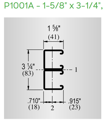

matthewobrn
Hi Waldemar,
This section is a cold formed channel. (Unistrut) It does not have a web or flange.
Can you please advise on how to add this parameter for a profile such as this?
Matthew

matthewobrn
Hi Waldemar,
Thanks for the quick response.
We have many profiles in various configurations such as the P1001A:
Is it possible to run analysis on such a profile?
As this Section Type is not specifically listed.
Or does this just define how it runs the verification on the custom profile?
I assume this means we will need to re-add all the profiles using this method?
This is more restrictive to the sections we have added to the database as the name is limited to 4 characters and uses Dimensions 1-3 in the profile name in our database. Can you please confirm this is now the case?
Matthew
Message 6 of 9
okapawal
Then the calculations will go as for the C-type profile without taking into account the middle part of the cross-section in the section class determination procedure. The class will be marked imperfectly - a slender web with the height of almost the entire cross-section and the shelves treated as supports - but certainly conservatively. There is likely to be a large reduction in the active field in compression and bending resulting in a conservative reduction of the load capacity.
Stretched, but will allow you to estimate the load capacity.
I'm afraid you need to re-add sections to the user database with these additional data.
