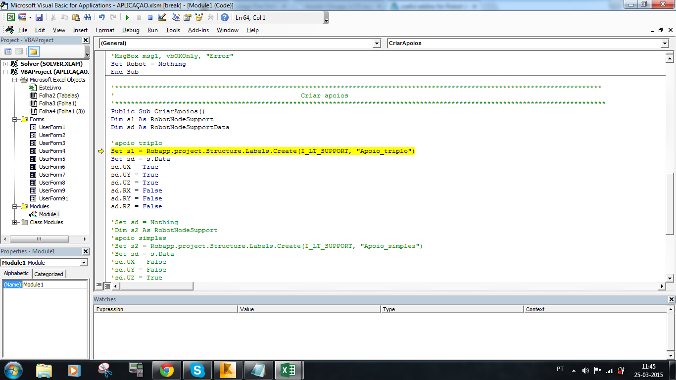

Before close that topic I have one more error (I'm to learnt yet) in my macro when I was create a new support. The error said "object required".
Please watch my printscrin.

Do you have this :?
Rafal Gaweda
Message 10 of 12
yes, I have in top (declarations).
But inside all subs () is necessary start by:
"Dim Robapp As RobotApplication
Set Robapp = New RobotApplication" ?
Message 11 of 12
I do something with you said, Public, dim and set and is running now.
