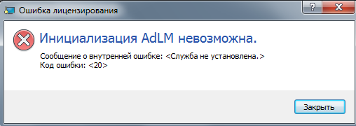

Romanich
Thanks Jad, I installed Excel x32bit version and saw this:
Have your question been answered successfully? Click 'ACCEPT SOLUTION' button.
Roman Zhelezniak
Robot Evangelist & Passionate Civil Structural Engineer
LinkedIn | Robot & Хобот | App Store for Robot

jad.dellel
Hi All,
RSA/RSAPRO 2012 licensing error which appears on 64-bit operating systems inside RESC (former name ESOP), Experts and Apilogs can be cured by installing appropriate one of the following hotfixes:
License error hotfix for 64-bit OS - RSA,
License error hotfix for 64-bit OS - RSAPRO
Both are available on Autodesk Robot Structural Analysis Professional Services & Support page, under RSA 2012 and RSAPRO 2012 sections.
In few days Apilog, Expert, and RESC Content installations on Subscription will be supplied with this hotfix adding missing license element during installation.
I will inform you when exchanging subscription installations is finished.
Best regards,
