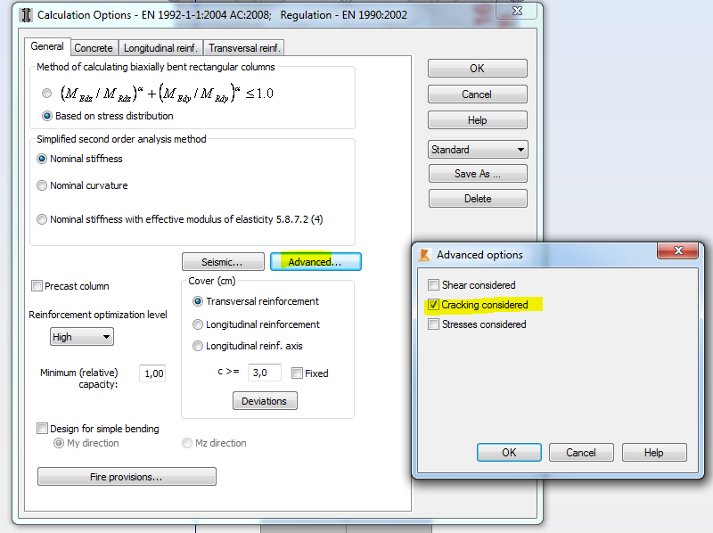

i solved the problem by calculating the model just with SLS combo.
I also have a problem with a column. The column is just subjected to a tensile strain and the results give me both steel and concrete reacting and zero crak, thought the concrete tensions are higher then the concrete tension resistance. Is it possible that Robot does not considere crack for RC column?

Hi @Anonymous
You need to enable this  verification in the way shown below:
If I managed to answer your question(s) press the Accept as Solution button please. This will help other users to find solution(s) much faster. Thank you.

I have a column with 1 m diameter, i made a SLS combo with a tension axial force of 2900 kN and a longitudinal  circular reinforcement with n°24 phi 25 bars. The crack width cannot be calculated cause internal force result to be zero. In the attached immagine i have reported the results.

Hi @Anonymous
If the check is enabled then it is verified.
