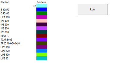

I have a VBA code to export bar data to excel. I'm trying to add a feature to color the cell with the same color as the section, but I'm having trouble with it.
I've managed to get the weight/m before, with barsecdata.GetValue(I_BSDV_WEIGHT)
but there seems to be no label to get the color of the section...

There is no Color property in IRobotBarSectionData.

And no workaround? No way to check what color is assigned to a section via API?
Stephane.kapetanovic
There is no documented method for this, so you are essentially on your own.
If you are creating a collection of sections from scratch, you could use an iterator to increment the color for each new section.
The colors (AppSec_) are defined in the preference files according to the selected theme (e.g. Color.ini)
There are other approaches by OCR and pixel-scanning of the legend image, but they are more verbose and complex to explain here.

Hi @geralA8ZZM,
As a follow-up to this thread, I put together a small demo tool that solves this the "hard way" reading the color directly from the rendered legend, since there's no API property for it.
How it works
  1. Open a Robot project containing bars with sections
  2. Open the attached Excel workbook and click the "Run" button.
  3. The program captures the active view as an image, locates the color legend in the bottom-right corner, and calibrates the scan width from the detected color swatches.
  4. It runs OCR on that calibrated legend area to read each section name, then writes a CSV (section name + RGB values) to your temp folder.
  5. The Excel macro reads that CSV back and lists each section with its color.

The software automatically detects the active theme, font, and text color. If the legend does not fit in the available space, as many views as necessary are created.
With font sizes below 8 pt, some entries may be omitted if OCR cannot read them reliably or if they fail to meet the 7/15-character matching threshold.

The macro is meant as a starting point, not a finished tool, since the CSV gives you the section name and its RGB color side by side, you can match it against your own bar export by section name, and apply the color to whichever cell/column makes sense for your export.
