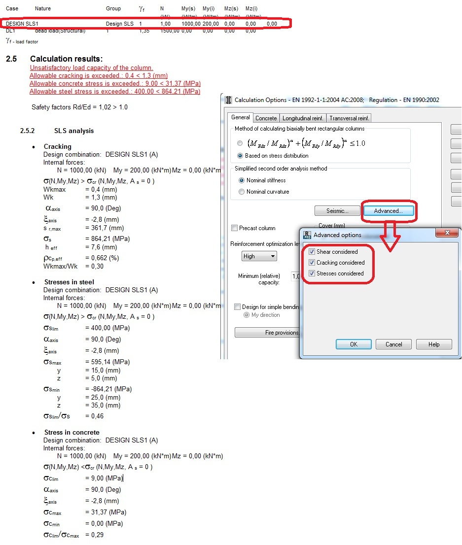

Hi Artur, I tried to see crack width in column according to Eurocode, but in table results always zero.

Have you defined SLS case?
Have you enabled SLS design?

I expected to see crack width in Required reinforcement results table:
Not implemented for this module.
Only in Provided Reinforcement of Columns.

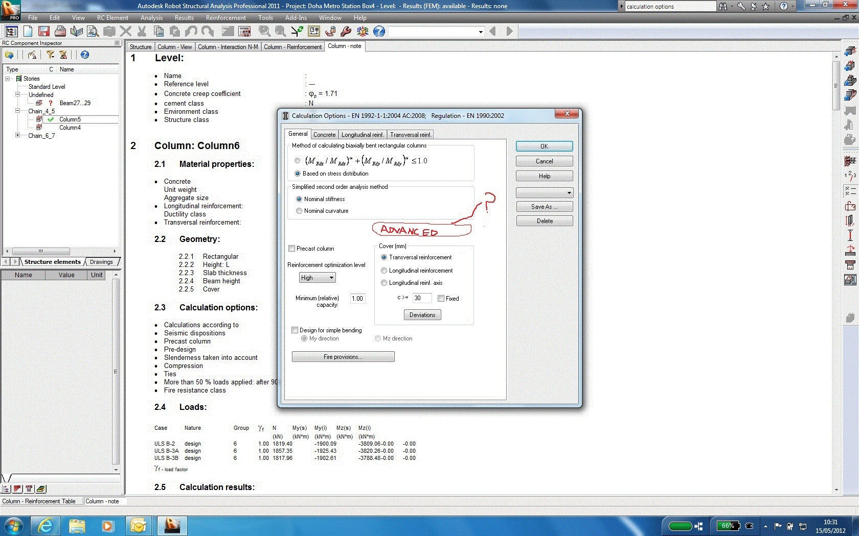

Hi. I can not seem to get my version of ROBOT (Structural Analysis Professional 2011) to check  a column for crack width. All I can seem to check are ULS cases, no SLS ones! In the screenshot belo you can see the "advanced" button (which I think enables checking for cracks) is missing. Is this feature not available in my version of ROBOT or am i missing something?
Regards,
Jon
Message 6 of 13
Romanich
Yes, this feature available only in 2013 version of Robot.

Rafal.Gaweda
Autodesk Support
Autodesk Support
As you may see from thread subject it is related to ARSA 2013.
SLS check for Eurocode columns in implemented in v.2013.
