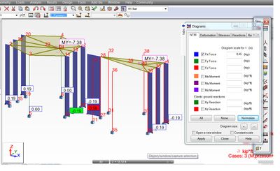

I have a question to "Rigid Links". What is the rule for the distribution forces from master node to the slaves nodes. Because I did a simple test for transfer Moment and Force (figure under), I blocked the UZ for the slaves nodes.
It is looks like depending from geometry of the slaves nodes.
I also tested an centric and eccentric master node position in terms to the columns.
Answer is important when we use "rigid links" for example to connect beam element and shell element.

You can think of a rigid link as of a very rigid bar element connecting a master node with a slave one. The unblocked d.o.fs can be then assumed as corresponding releases applied to this bar at the slave node end.

Ok. That's right - for simple situation. But I still don't know why I received the results on the below figures.
In HELP (F1) I didn't find the answer.
It must be some rule according to which forces transfer from Master node to Slave Nodes ( when we have more slave nodes) - I suppose it's geometric rule.  Most of the programs (FEA) have the similar function "rigid links".

Some programs have  some geometric rules and if I remember correctly STAAD uses or at least used to use something like that (sort of having the same displacements for connected nodes) but in Robot it is as I described it. Try to replace rigid links with rigid bar elements with appropriate releases at the slave nodes when applicable and compare the results.
