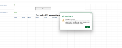

Simau
Macros might be disabled.

saclovitzky
I open now the apps but just wondering why there's no result in node 3?

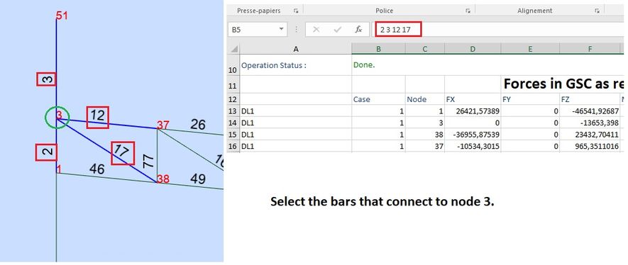

please find results for node 3
M. Agayr

@saclovitzky
M. Agayr
