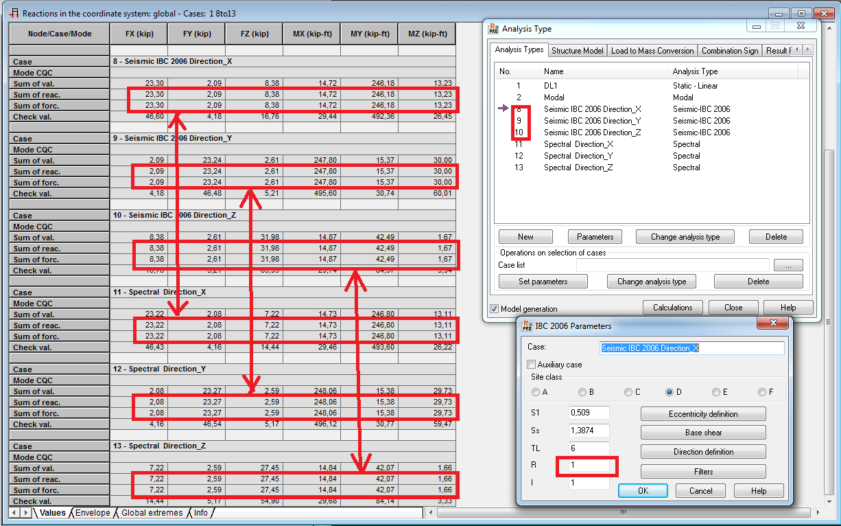

the main reason of difference between seismic load cases and spectral load cases in your last model was the behaviour factor R=8.5 used in seismic load cases. It results in reducing spectra for calculating forces, momenta and reactions.
After setting it to 1 the results aree close to each other - see below.seismic vs spectral.png
Some reason of difference is also in spectra - for instance the automatically generated spectrum for seismic load cases has the maximum value between 0.11 and 0.55 seconds. The spectrum defined by you for spectral analysis has the maximum value between 0.11 and 0.50 seconds.
It can be seen graphically in the  calculation note using Analysis>Calculation Report from the pull-down text menu.

So Robot scales the Seismic results by dividing by (R/I), which is in the code (ASCE 7-05 Section 12.9.2).  When I entered the Static Base Shear into Robot for each direction, the reactions were scaled to the base shear value.  There are certain code limits that I need to make sure are being checked, but I'm feeling better about this.  Attached is a sample work flow to calculate the scaling factors for ASCE 7-05 (IBC 2006).  Note for cases where the dynamic base shear is less than the static base shear, the ASCE 7-05 sets a minimum of 85% of Static Base Shear.  Is this being taken into account?  Is there a way to view the unscaled dynamic base shear?  I would like to verify the dynamic base shear is being scaled correctly.
To get unscaled base shear results, would I enter 1.0 for R and leave the base shear section blank?
Pawel.Pulak
Autodesk Support
Autodesk Support
Yes, to get unscaled values R should be set to 1 and "Base shear" should be set to "Inactive".
