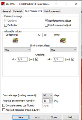

Hi, as I am using robot to design a reservoir, I get funny results for required reinforcement in slabs.
Robot doesn't seem to take into account cracking when performing the calculations. See below, for a 1000mm thick slab it gives me a max reinforcement equal to 703.59 mm2 at the peak. However when checking the forces at this particular point under worst SLS combination and I have a bending moment equal to 214.80 kN.m/m and almost no tension / compression. When doing the calcs by hand I get a way higher value!
Reinforcement required according to Robot
Reinforcement requiredReinforcement required
Axial force under SLS
Axial force under SLSAxial force under SLS
Bending under SLS
Bending moment under SLSBending moment under SLS

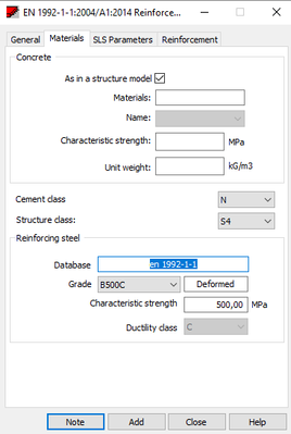

I think I have correctly set the parameters.

did you notice that you don't have the minimum ammount of reinforcement as defined in EN1992-1-1? and that your moment is less that half of the cracking moment and maybe even at ULS your section isn't cracked at all?
But i can share my experience with cracking calculations in RSA:  i always do my checks by hand. Eurocode formulas are mainly for bending and have a lot of know problems (search Professor Beeby’s in structural concrete magazine) and you should see them as a good "quality" estimator. Putting this type of formula in a numerical algorithm is a nonsense in my humble opinion. But this is another subject that I'm sure other colleagues can share their opinions.
Regards
mathias_peron
Thanks rsousa!
No I didn't notice the section wasn't cracked, thanks for making me aware about this. Yes I deactivated minimum reinforcement to check my crack widths hand calcs.
Thank you again 😉
