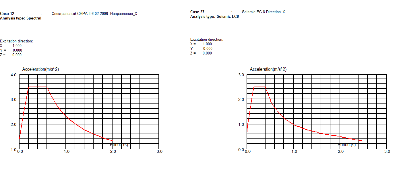

I'm sorry but I don't feel like my knowledge is good enough to tell if the definition of the response spectra you used in the model is right or wrong but it can be seen that comparing with the EC* seismic analysis with the default settings it produces significantly larger forces. I'm attaching the comparison of the spectra for these two situations:

Please tell me, when you compare our my spectrum with spectrum of EC8, what acceleration, and the type of foundation set in the settings EC8?
I have ag = 3 m/s2, the type of foundation on Eurocode =''C''.
Please supply these values, and attach the form of the spectrum for comparison with my spectrum.

My point wasn't about your spectrum being wrong (I don't have enough knowledge to tell and on the contrary as you already compared it with other resources I would assume it is actually correct) but the fact that it produces large forces. You need to determine if they are right (and then increase sizes of columns) or seem to big. For the latter you may check if you shouldn't apply behaviour factor and e.g. divide the seismic forces by the corresponding factor. You may want to look at e.g. http://www.scielo.org.za/scielo.php?script=sci_arttext&pid=S1021-20192010000100003 (table 4) or look at the table for another source shown below:
