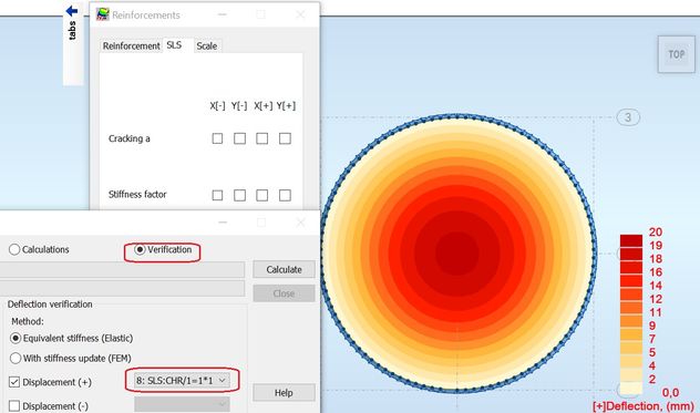

I am designing a relatively simple thick RC slab.
The analysis indicate defections equal to 18mm. The bending results are as expected.
In the reinforcement design the deflection's are shown as 101mm and the rebar required way above the expected.
Why is there such a great difference between the deflections in the analysis and the reinforcement design module.

First are you sure about the direction of the LL1 load case.
You can't compare the deformations from Maps and those calculated in required reinforcements which depend on the parameters in "reinforcement type"

The model is of an  shaft base. The LL is due to water pressure/heave this is why it is pointing up. The FOS are also slightly different from the FOS in the codes.
I an relatively new to Robot and still getting grips of how it works. In the slab model V1 there 2 different displacements indicated. One 8mm the other 20mm.  What loading condition do the 8mm and 20mm represent? Does the reinforcement area (required/provided) affect the deflections output? Can the crack width limit be changed in "reinforcement parameters". I have tried to change the crack width limits as an experiment but it did not affect the results.
