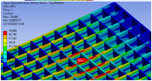

A few months ago I used Robot Orthotropic Panel to check stress on a square open GFRP.
Obviously after the information regarding the problem with accuracy of this sort of calculation, I went back and check again using a shell model and Ansys.
Fortunately the stress distribution on the panel model is very similar to the results on the shell model. Phew.
Just thought it was interesting and wanted to share.
