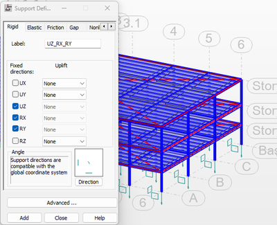

Hello everyone,
I am a new user of Robot analysis, and I am designing a steel building with robot, but unfortunately, I cannot figure it out why i keep getting the error message for non-convergence in the analysis. If anyone can give me guidance because it keeps failing i would deeply appreciate it.
Thanks in advance!

suxho95
Hi Rafael,
Thanks for the feedback. I tried to change the parameters that you mentioned, but the system still keeps failing due to no convergence of system. Attached is the screenshot of the model.
Thanks!

DennisVDijk
Hello @suxho95,
I looked at your model:
[1] all your supports were released horizontally, X and Y direction;
if you want pinned support UX, UY and UZ box must be ticked, full restraint all boxes must be ticked etc. etc.
[2] all you concrete slabs are "slab - rigid diaphragm" if you want the in-plane stiffness of the slabs just use shell.
For a good mesh u should first take the thickness of the slab as a mesh size:
I think 1ft is about 12 inch (im not sure, i use metric)
[3] all you load cases and combinations are on auxillary, you get no results
wind and seismic on auxillary
[4] I'm not sure why you use DAM, i turned it of and your model runs.
I hope this will help you.
Model attached:
Kind regards,
Dennis van Dijk
Structural engineer
www.ibureaunoordwolde.nl

Simau
Hi @suxho95
In your model I corrected a geometric discripancy,
I set the diagonals as truss without releases.
I deleted the releases in the beams in Y direction so that they work as portals with the columns.
I set supports as "pinned".
The main model works fine but with huge displacements
Before you resume DAM, you have to correct your huge loads
Same for LL rain snow
