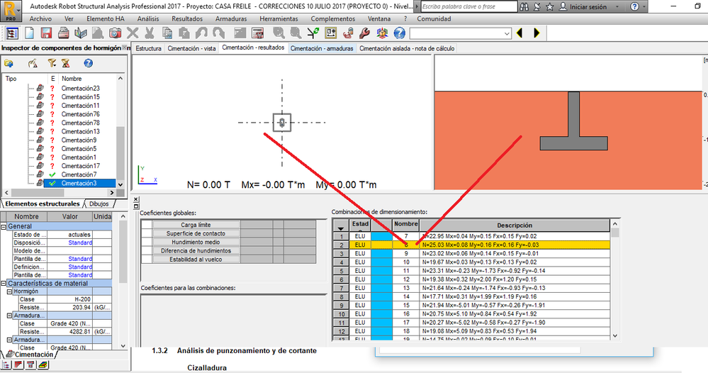

hi,
I don´t Know why ROBOT Doesn´t show the stress, what can i do?,  I will appreciate any help
ROBOT does not show the calculation and the soil capacity

Hi @Anonymous
You have to have SLS combination for this check (there are only ULS ones which you imported to the RC Spread Footing module) in your model.
