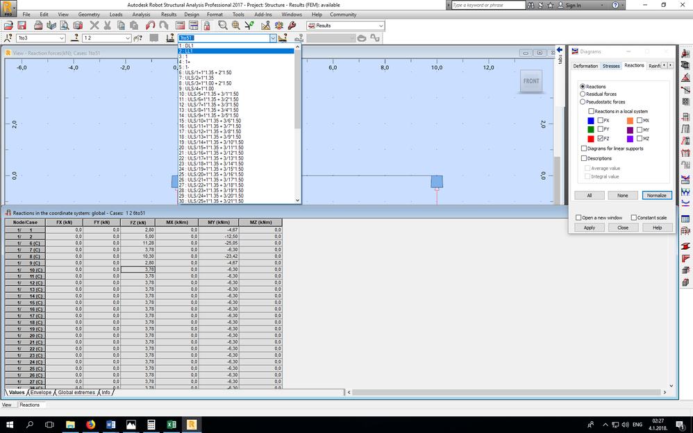

Results form moving load in combinations are not calculated.
In the attached picture you can see that the combinations are generated, but the resulting reactions are the same regardless wher the force is located.

Hi @vuk.vukanic
Please check the definitions of the combinations:

vuk.vukanic
Thx this was helpful, but still I have no clue how it works...
So even if the name is correct there is a chance that the definitions is no good?
How come?
Looks like to create combinations with moving loads first one needs to run the calculstion without the comb. and only after reset the combination rules and generate them.
Is this correct?

Hi @vuk.vukanic
If you want to create manual combinations generate the positions of the vehicle (run model generation) first.
