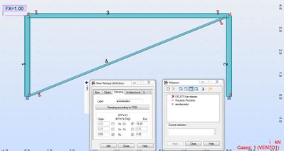

Hi all,
On studying this case , some doubts about the program  results led us to do some tests using a small frame model.
1- For TH case ,Sinodal F-T function according to 1st mode frequency is applied to VENTO1 Load case.
2- Brace is fully axially released at the botton and a damping coefficient is applied.
3- If the TH analysis is linear , everything behaves as expected
4- If the TH analysis is Non-linear or P-delta , the structure behaves as if there is no damping applied to the brace  and only the global damping acts.No matter what value is assigned to the brace damper , the results are the same.
5- Calculated Total mass(739,39kg) on modal results doesn´t match with structure total mass (1048kg , on quantity survey)
Model is attached

Confirmation. Unfortunately if Non-linear or Non-linear and P-delta analysis is activated in time history analysis the dampers existing in the model are ignored.
Reported to dev team.

Yes, any kind of viscous damper (defined in releases, compatible nodes or in supports) does not work in case of nonlinear time history.
Rafacascudo wrote:
Is there any other workaround to solve this problem , or  for now , any kind of damping is incompatible with any kind of nonlinearity??
In such case it is possible to use distributed damping, defined using Alpha and Beta coefficients. It was suggested some time ago by Tuctas in his post.
Rafacascudo wrote:
Was this always like that or it worked in any of the previous versions of the program??
It was always like this - since the implementation of viscous dampers in v.21 😞
