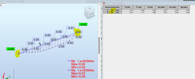

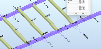

How can i check the moments in a beam element at face location.
Message 11 of 11
Krzysztof_Wasik
Autodesk Support
Autodesk Support
Hi @bhawesh_lohaniE3UGF
Open Results >Forces then select required load cases and member.
Program shows results in member/beam endnodes (by default)
Krzysztof Wasik
