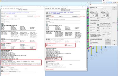

Hi
I have created a structure with 2 floors with same load applied at each floor. After calculation I have some beams with member stability check and others not. What is the explaine for this? The member type is the same for the beams.

The example of beams are 24 (no estability checked) and 33 (stability checked)

None of them are checked. The slightly difference in the ratio is du to the offset you added to member 33

That's correct but my question is why in the beam 33 you have the stability checked and on the beam 24 not checked?

It's because member type viga is not correct.
Use instead viga_V1

Even if I make the change on the member type still don't have the buckling parameters in one of the beams (24).
Why can't have the same parameters in both beams?

Update member type viga as in the picture below and save it.
Model attached

I made the changes and the result is this...

The reason why you have that extra buckling verification is because you have compression in the beam.
Take a look at the axial forces, for the one with the verification you have compression, for the other you have tension. Tensioned elements do not buckle.

Understood now!
