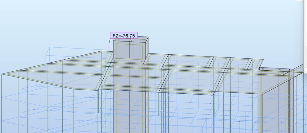

Hi;
Just from doing the loadtakedown on column in RSA, and why do RSA doesn't take into account the floating columns and many others columns during the load takedown?. Even for the corner columns, the moment(M)  is not taken into accounts. I'm i right or there's a workaround to get this result. Need a hand in this 🙏.

Hi @Djokaboris
Load Take-Down is a simplified method which simulates transfer of the vertical loads down to foundation.  It does not generate moments on columns.

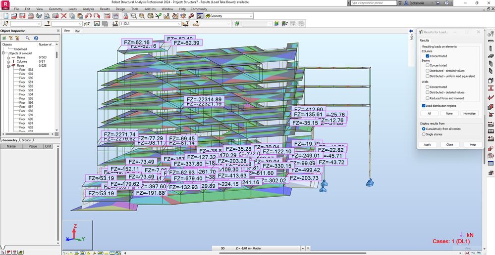

Djokaboris
Yeah Sir @okapawal i understand, but i wonder why it doesn't take into account the axial loads from level2-4.  robot doesn't take into account the load takedown and distribute axial load in floating columns structures or am i mistaken. And why is it that in the structure there are not axial load from load takedown in most of the column. I understand that sometimes there might be RC tension column that doesn't receive any load, but not for almost all the structures like that

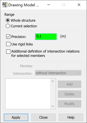

@Djokaboris
Actually, in both attached examples you are using regular FE method, not the Load Take-Down.
Pay attention that beams and columns are not connected at some points.
You may run Edit > Correct Drawing Model..  command to make coherent model.
at least with 10 cm tolerance.

Djokaboris
Thanks for your answers sir @okapawal ,  the overlaps found by RSA when using shells are only due to beam supported by beams. i used a precision of 10cm but still columns from level 3 and 4 don't receive  normal force(N) after load takedown.

Djokaboris
Thanks sir @Stephane.kapetanovic , did the correction, but the only warning right now is instability type3 that i'm unable to detect. Did load takedown but still no compressive load on a lot of columns
Message 8 of 28
Djokaboris
Finaly work the whole day on the error and corrections. Thanks Sir @Stephane.kapetanovic , Sir @okapawal  ,this is an updated structure with no errors but still a lot of columns don't have compressive load during load takedown. Don't get why RSA does that
