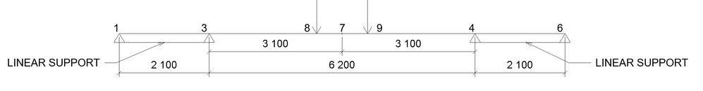

I have steel beam that partially lying on concrete wall, that means i need linear supports . I dont know how to make this partially linear support in my model.

Hi @Anonymous
You can do it in two ways:
1. generate number of nodes along these spans and apply supports to them
2. Geometry \ Additional Attributes \ Bar Elastic Ground, specify high value for Kz, assigned it to bars(spans)

When you say high value for Kz, how high i shell use ?

Hi @Anonymous
To not get deflection on spans
