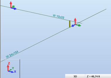

I have placed rigid links in my model. I have W10x33 beams resting on top of W24 girder beams. The W10's are bolted to the top flange of the W24's. I placed a rigid link between the nodes for the bolt. When I run the calculation for just dead load, I have instabilities in the nodes on the W10's for the rigid link. Iam not sure what I am doing wrong. I have attached my model and a screenshot. Any help would be greatly appreciated.

@Wendy_smith
Set Bolt rigid link like this

@Wendy_smith
In your model, you set bolt as below
Which means that your bolts don't block anything (Ux Uy an Uz are free)
In my bolt setup, to ux uy uz, i added rx to avoid instability. Bolt rx corresponds to the strong W 24x104 inertia (UY)
What does a Welded rigid link look like?
As below

@HoshangMustafa
Below a workaround, but maybe there is a quicker solution.
Select all W10 33 members, then look at fz diagram to calculate reaction at these nodes.You may then design your bolts under these reactions.
To be conservative you can select all W 10 33 members and take design reaction as max Fz + Min Fz
