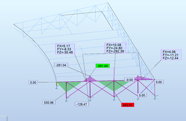

I would appreciate if someone can help me resolve the following error types:
1 type RZ
2 type RZ
2 type RY
I have used releases but customized it to restrain the RZ. However still I get RZ error. FYI, in my model I have used rigid links to transfer loads from main to secondary beams and used cladding to transfer UDL to the beams.
Also, I don't understand why I get instability error at node 95 in the mid span!!!
on other hand, I am getting very large unexpected BM at the support while no such load is applied to cause that:
Also, I get non convergence error when I use tension only braces. I tried to solve through setting the DL and LL load cases as auxiliary and "matrix update after each iteration" but still that didn't help.
FYI, I found some inaccuracy in my model (two members not exactly intersecting as I imported my model from CAD file) but used the tolerance option to overcome that.

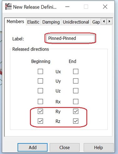

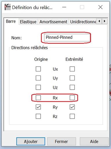

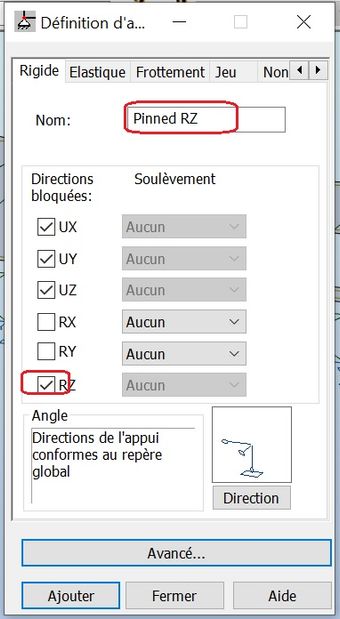

Hi @nali_ameen
Change:
- Supports pinned to pinned- RZ
- Release pinned-pinned as in the picture below

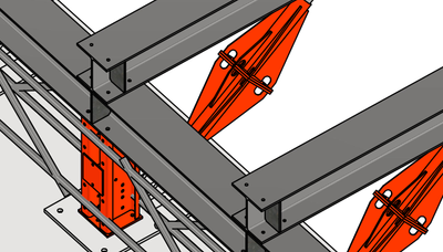

nali_ameen

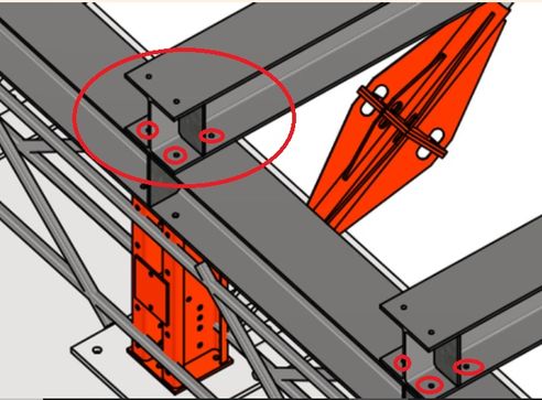

Thank you so much @Simau . In reality I don't have moment connections for the beams! they are just restrained in transition as shown below:
wouldn't restraining Rx result in inaccuracy for my model?

Simau
@nali_ameen
No i don't think so, its only for avoiding instability as tortional bending moment is very low

@nali_ameen
The torsional bending moment can easily be taken up by these 4 bolts.
M. Agayr
Message 6 of 20
nali_ameen
Thank you so much Simau. yes, exactly, torsional is restrained in my case but bending in minor and major is not restrained. I was confused between the local axis until I switched on the local axis display.
Message 7 of 20
nali_ameen
Hi @Simau ,

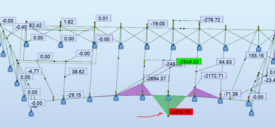

I just noticed unexpected BM diagram at the edge beam!! I get very big positive bending at my column locations as shown below:
but if I remove the TRUSS property and simply make the braces pin-pin, then the result looks more realistic, as shown below:
have you got any clue for such behavior?
Thank you.

nali_ameen
Thanks @Simau, I added the new opening as I don't have UDL in this area. But I don't understand why BM in the edge beam is almost zero when I use pin-pin brace but BM increases a lot when I change the brace properties to TRUSS!!!
I added the beams as you advised (though in reality I don't have such beam) but BM become even bigger.

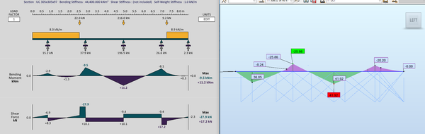

I did a simple 2D analysis for that edge beam, but the results are so different from Robot!! (as shown below). honestly, I don't expect to have big BM near the columns as the point loads are very close to the support!!
Attached is the model after adding the beams.
Thank you in advance for you support.

nali_ameen
The results make more sense when I change all brace properties to pin-pin (as shown below)
I don't know what's wrong with using TRUSS release option!!!
Message 11 of 20

Simau
@nali_ameen

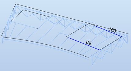

Your model works fine if you add bar 69 103
Model attached

nali_ameen
Thank you so much @Simau , you are really amazing 🙂 may I ask why adding these two members change the result that much?! (honestly, I am interested in that as I don't have these beams in reality).
Also, in the absence of beams 69 & 103, the BM is very high in the edge beam with TRUSS modelling but somehow ok using pin-pin. I didn't understand the reason for this as well.
