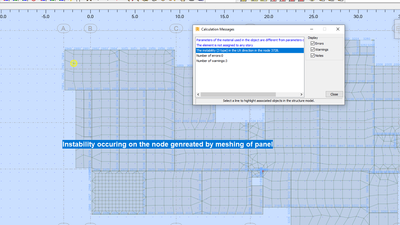

I meshed the floors and there was no incoherent edges generated. but while calculation, I realised that instability of type3 is generated at the node created by meshing.
can that be ignored?
if not then how to solve it?
I tried deleting meshing and meshing the panel locally. But after doing so the instability warning came for another panel

The instabilities can be generated by geometric irregularities not framed by the tolerances of the model.
For example in your case:
Junction of panels 1052 - 1057 (more than 2mm) node 3283
Panel 1062 have a small edge (6), 1077 edge (3), 1100 edge (3)
Beam 42 to 45 47 48  155 not perfectly X bar that may cause geometric analysis difficulties.
After checking the model if instabilities type 3 still exist you can ignore the message and check your results (large rotations, displacements, mesh nodes with concentration, etc.)
