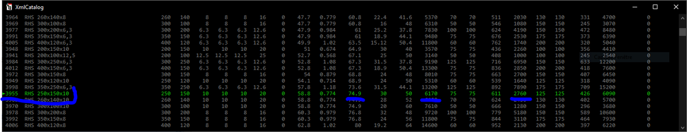

Hi all,
During a recent verification of section stresses, we discovered a significant issue in the CORUS catalogue within Autodesk Robot. The RHS 200x150x10 section has been incorrectly assigned the section properties of a RHS 250x150x10. This misassignment could lead to serious inaccuracies in structural analysis and design.
We urge Autodesk to investigate and correct this error as a matter of urgency.
In the meantime, we are conducting an internal audit to verify the accuracy of all section properties in the catalogue, as this raises concerns about the reliability of other entries.
JLIUXJJG_0-1760625125517.png- Robot details
JLIUXJJG_1-1760625214455.png- dlubal details
Looking forward to Autodesk’s prompt response and resolution.

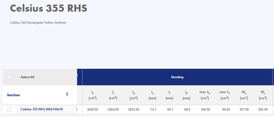

Hi @JLIUXJJG
Here is an extract from the Corus database and the RHS250*150*10, the values ​​seem the same. Could you tell me what needs to be corrected?
It is likely that your catalog specifies that the radii of curvature are for reference, and that the listed characteristics are calculated from dimensions and not guaranteed.

okapawal
@JLIUXJJG
Section properties for RHS Corus database in Robot seems to be correct comparing to the available data...
Celsius 355 RHS design guide | Tata Steel UK

JLIUXJJG
Hi Stephane,
Thanks for your speedy response. You are correct, the section properties for the HRHS section are correct. The issue we are seeing is that there is a second section within the Corus database for RHS sections - here the 200 x 150 x 10 RHS has the wrong properties. See snips below of where the problem section is
Can you please confirm what this sub data base is ? Is this also visible for you? Please can you check this section for us specifically. Your assistance in getting to the bottom of this is much appreciated.

As I see it, manufacturers are the ones who provide details about their ranges and section properties. Checking every tube section is neither my job nor my responsibility.
The RHS 200x150x10 (ID 3797) appears to have the same properties as the CHRS 250x150x10 (ID 3955). I agree with you, but should the RHS 200x150x10 be deleted or modified?

I first thought you were comparing the Dlubal web database with the Corus one, but it’s actually as accurate as the Corus Celsius database. Since you found a section that doesn’t match the expected properties, I’d suggest correcting or deleting it.

in the Corus database, you must check these two items, knowing that everything depends for the others on the fillet radius
ID 3796 RHS 200x150x8, ID 3797 RHS 200x150x10
