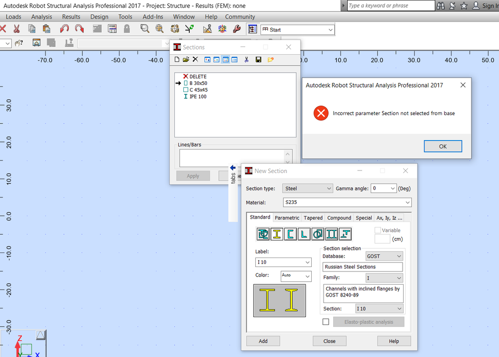

INCORRECT PARAMETER SECTION NOT SELECTED ON BASE
444 Views
445 Views
Rafacascudo
You have to define the distance between the profiles, at least the size of the profile flange
Rafael Medeiros
Rafacascudo
https://forums.autodesk.com/t5/robot-structural-analysis-forum/material-list-vanish/m-p/5704200#M354...
Rafael Medeiros
