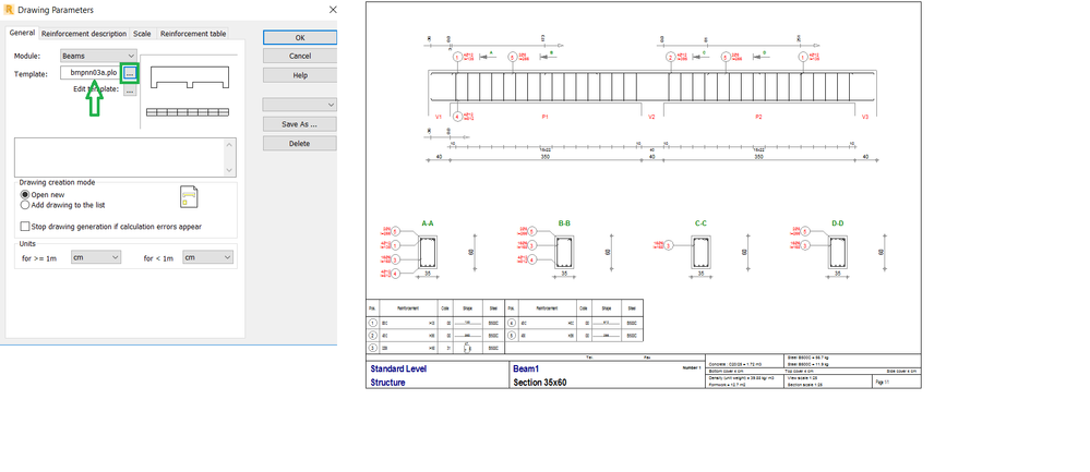

Hi @george.elhaddad
The way it is shown depends on the selected drawing template:

Thank you Pipper for the tutorial. This is what I used to do, and it takes lot of time to edit and finalize the drawings.
Thanks to Artur, there is always a solution in Robot.
