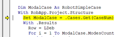

but its not working in 2025 ROBOT
any solution

Can you explain the error message you are getting ? Have you installed the SDK ?

yes the SDK 2025 is installed, I have Office 2021.
ill share the file and the error messages.

You've probably chosen a case that isn't a modal case for you
Updated 14/07/24 - Added a drop-down list

thank you so m606.uch for your help i have made a lot of progresse
