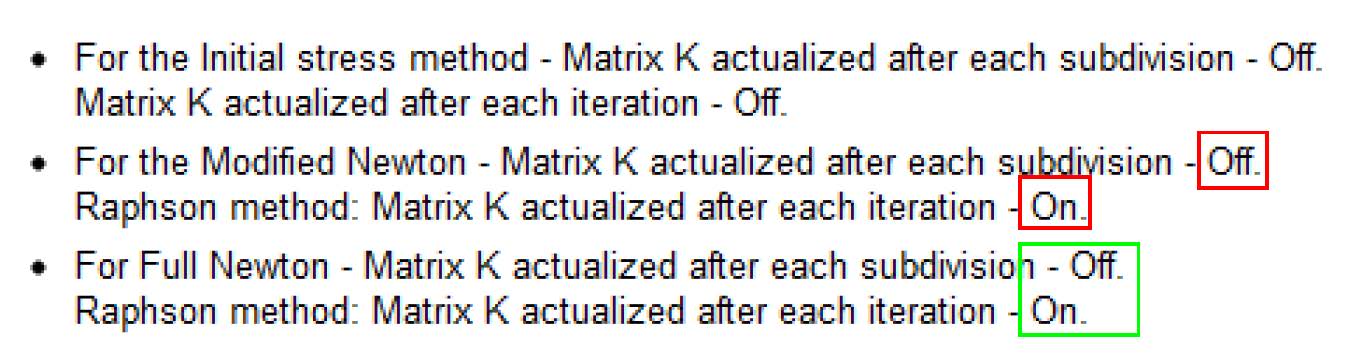

Hi
Is this a typo?
link to help page:
http://docs.autodesk.com/RSA/2012/ENU/filesROBOT/GUID-FB3C86D3-0E30-43A6-82D6-6C50F429FA0-600.htm
Both descriptions are the same.

The correct settings for both NR methods are shown on the attached picture.

We do our best to introduce as many corrections and improvements as possible but please note: Not all identified issues are considered significant enough to address in their entirety; a proposed correction may create significant stability risks; some issues may be impossible to fix due to product architectural restraints or can be introduced in a specific time frame only. Thank you for your understanding in this matter.
For this particular situation the analysis dialog clearly indicates which method is being used. In addition the results for Full NR and  Modified NR method are the same provided the analysis converges so the selection of the check boxes should not cause any issue for a user.

Fixed in the online help.
See:
http://help.autodesk.com/view/RSAPRO/2015/ENU/?gui​d=GUID-FB3C86D3-0E30-43A6-82D6-6C50F429FA0D
