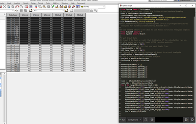

Hi all,
We are currently upgrading our scripts from IronPhyton 2 to CPhyton 3.
I want to get the results of node displacement using CPython3. The code in IronPython2 cretes 6 lists of results in UX,UY,UZ,RX,RY,and RZ, please see picture below.
In CPython3 I get the following error: Warning: AttributeError : '__ComObject' object has no attribute 'UX' [' File "<string>", line 41, in <module>\n'].

I have been trying to change the code with the following classes, but It is not working.
node =  IRobotNodeDisplacementServer
node_dis = IRobotDisplacementData
Could you help me to solve the issue?

JacquesGaudin
I think this one is quite easy, just cast the result of the `Value` method to IRobotDisplacementData and it should be ok.
Note that rather than calling six time the `Value` method, you're better off calling it once and storing the result in a variable.
