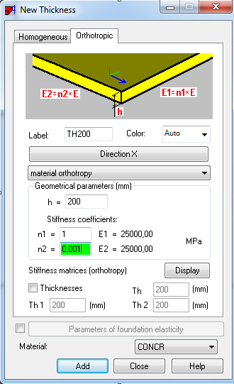

Use an orthotropic slab to make the slab truly one way spanning.

Rafal will have a look at your file but I think that in the typical situations you can try to mesh panels and use the thickness definition shown below:

Artur, thanks for the advice on orthotropic slabs.  Now I just have to  decide on realisitc stiffness coefficients to account for the steel reinforcing in each direction.
