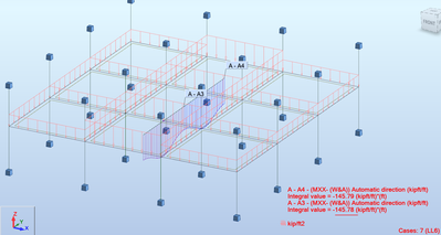

I have the US customary unit version of the example and the loading pattern they describe is very convoluted I am only able to get results similar to the example by putting no loading in the A panels at all which is counter to the description and common sense as dead load must exist in that panel.
I would compare the full strip positive and negative moments for the fully loaded case, which I get nearly exact agreement against.
Message 11 of 31
DonBAE
Ok the example needs to be viewed in the context of an equivalent frame in that regard I believe the loading to correspond to their load case (b) is actually the 0.75*live load along the central span panels and full dead load in the adjacent spans. This produces a central span positive moment that is much closer to the values obtained in the example:
Using moment distribution without consideration of rigid offsets or the torsional member similar moments are obtained on the assumption that only the central span is fully loaded:

sorry I'm not able to we only have ARSA 2024. You just need to change your loading so that the central strip of panels is loaded with the live load and the flanking panels are loaded with dead load only.
