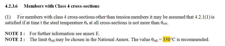

for column 233 temperature/time domain and resistance domain give not the same results:  Tcrit = 350°C at 10.6min.  -  at 60min,  Ed = 0.75 Rd, Tmax 934°C.
Tmax > Tcrit but Rd>Ed
why column 233 not axially loaded does non have the same results in the two calculation methods?

For HEA500 I get the same sesults for both method (resistance, Tcrit and time limit).
For IPE600 : for resistance method: resistance verification 0.78, reached temperature = 934 °C; but for Temperature/time domain method Tcrit = 350 °C

Bar 233 is of class 4 therefore the critical temperature is limited on 350 whereas for the resistance domain method has got no such limit therefore IMHO you can't compare results.
