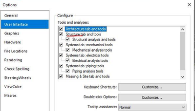

Do you have Structure tab visible in the ribbon?

Yes the structure tab is visible in the options if you mean the ribbon like it's shown in the following screenshot:

Yes, I can reproduce the issue on this template.
I will ask development team for checking.
