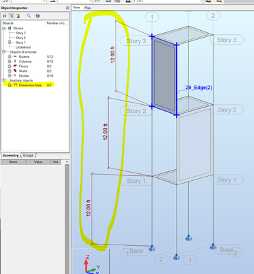

I build a simple LTD model. And getting error 5000?  I'm running robot 2023 on the virtual machine. Can this be an issue?  I don't have a problem with others models.

HI @m_sheinin
Could you share the model for verification
(Save it as RTD without results and zip before sharing)

See attached model.

HI @m_sheinin
It is very strange effect, but it seems that problem is caused by dimension lines.
After deleting dimension lines (particularly bottom dimension line), model can be calculated.
I will register that for verification.

Hi @Krzysztof_Wasik,
Thank you for the solution. It did work.
