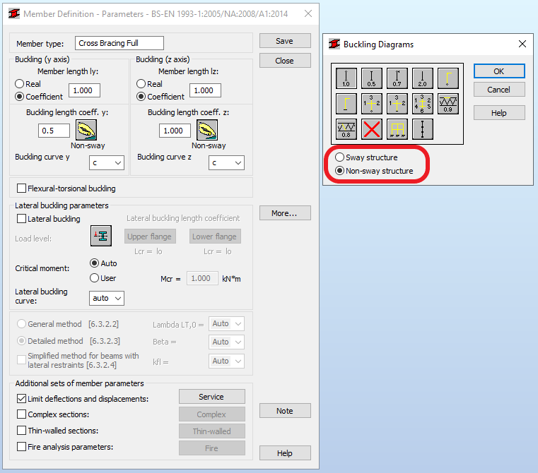

Could somebody please explain to me what do these parameters shown below mean?
The help menu doesn't say much about them.
1) On the first image: If I define a buckling length, or select one of the predefined options, does it make any difference if I say that the member is sway or non sway? When should I use this option?
2) On the second image: Do pipes refer to hollow sections in general, or just round pipes? I am asking becuase further below it distinguishes and asks more specifically for round pipes.
Also what is this f_yb and f_ya parameter? Any reference to the Eurocode please?

Hi @kostastomp
Ad1 Buckling length coefficient calculation
When sway option is on automatic procedure for buckling length coefficient calculation
allow element horizontal displacement ( frame with no bracing)
In most cases buckling coefficient calculated automatically will be >1
When non-sway option is on, automatic  procedure for buckling length coefficient calculation does not allow element horizontal displacement ( frame with bracings)
In most cases buckling coefficient calculated automatically will be <1
Ad2.
Fyb and Fya refers to cold formed sections, EN-1993-1-3
paragraph  3.2.2 Material properties of cold formed sections and sheeting.

1) the difference may be illsutrated with these two screenshots.
Non-sway structureNon-sway structureSway structureSway structure
2) It is not clear. To be honest, i don't know :/. Maybe just to condiser that hot rolled pipe have a yield stress slightly lower than cold formed pipe. Someone else have an idea ?

Paul, I know what a sway and and non-sway frame is. The fact that the sway-non sway button is not greyed out when selecting one of the standard (non automatic) buckling length settings.
