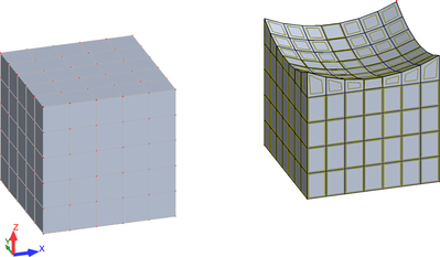

I also recommend that you try the automatic detection feature in the panel creation dialog box. if you have several bars in a closed outline format, you can easily create a panel from an internal point.
Then if you need to split a panel into several based on the mesh, there are several methods.

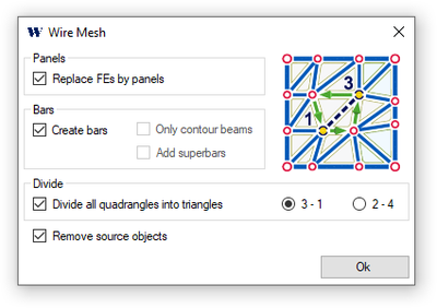

You'll find  GetPanelWire  a small software utility that lets you create panels in place of FEs, even when they've been transformed manually or by API.
  Stephanekapetanovic_0-1768593336323.png      Stephanekapetanovic_3-1768929115804.png          Stephanekapetanovic_0-1716097886073.png
It's a limited version, but it's exactly what you need.
