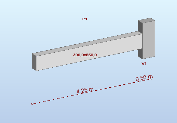

I am trying to design a beam that is supported by a panel (shear wall) on one end and by a bar (column) on the other end. see picture below.
When i import the beam in the Provided reinforcement module, Robot does not recognise the wall as a support and considers that the beam is a cantilever supported only by the column on one side, see picture below. How can i solve this?
could this have implications on the anlaysis?
When i import the beam in the design module it gives me the option to select the supports but the support given there is a node on the slab.

Mark both check boxes during the import and adjust the width of the wall support if needed inside the RC Beam design module.

As Robot assumes end nodes of a beam in a model being in the centers of te supports you need to either:
- define this beam as a 'longer' one till the middle of the'width' of the support you want to decide on during reinforcement design
or
- change the support type to masonry
For the maximal moment in the span it is the accuracy of the number of points the values are taken from
