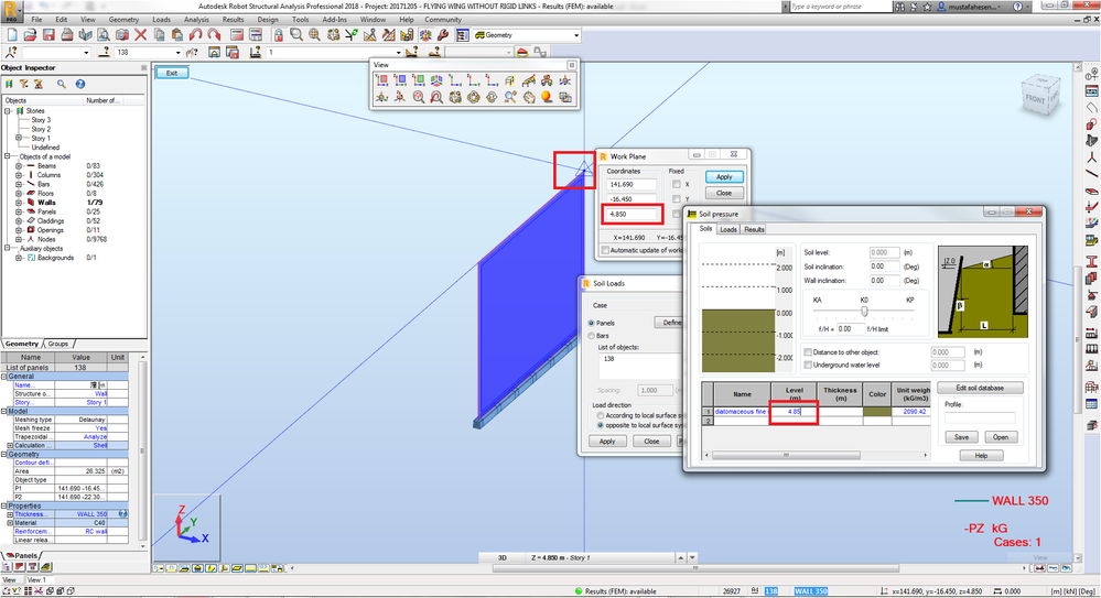

Good morning, friends, I have a question, in the option of special loads by pressure of the ground, if very well it is generated, the calculation note when I add to it a distributed load, I get a message indicating, that this does not affect the calculation, I saw in one of the solutions a solution to this, but for more than I try not solve

Mind to match the level of the soil with the Z coordinates of the wall.

Its working well, If you could please send us the soil parameters you applied it in soils page in order to check it .

Please check the top and bottom level of you retaining wall.I guess both of top and bottom level are above  or under soil level.
