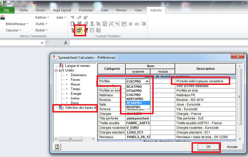

How can I change the database of profiles (by Canadian) than Spread Sheet Calculator?

1. Copy attached Canadian section database file to C:\Program Files\Autodesk\Autodesk Robot Structural Analysis Professional 2013\RESC\Data\Prof folder
2. Set Canadian section database as default

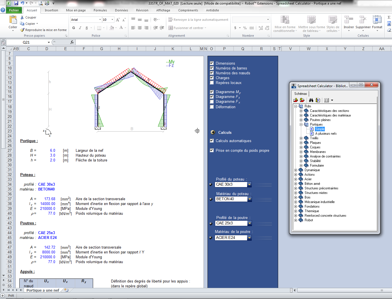

Change Preferences to English or English (US)
