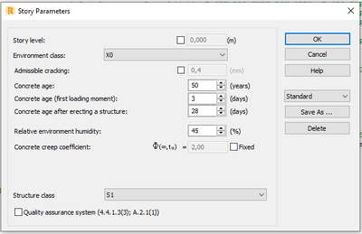

ext_julien_lebertMYQZ9
Hello, thanks for all the explanation. It's really helpful.
But I have a problem. I can't choose many parameters, like those who are in "Story Parameter" or "Footing Reinforcement". Can you help me, please?
